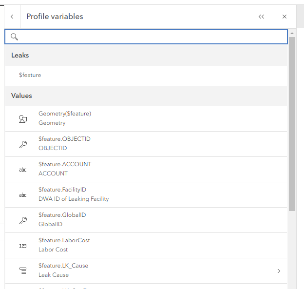

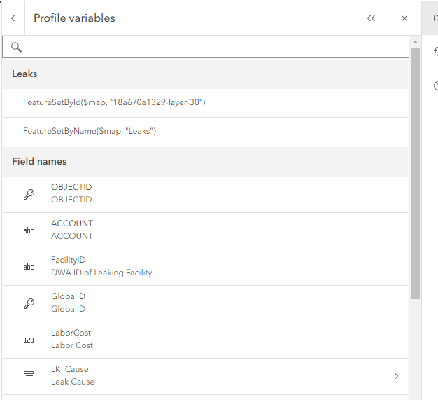

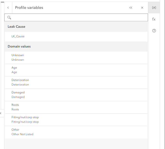

So I just noticed something that may be key to this.  When creating the Arcade if I go into the current layer $feature layer and go to a field with a domain it gives me an option to just choose the DomainName function already filled in.  It does not have that available when I go to the $map variables.  This makes me think I cannot get the domain from a map variable directly.  I must of figured out some work around, maybe something to do with relationships.🤔
$Feature with DomainName available$Feature with DomainName available$Feature$Feature$Map no DomainName available$Map no DomainName available$Map$Map
