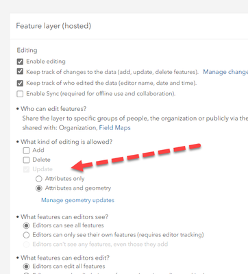

I am trying to set up workers with the ability to edit attributes within a layer and table through fields maps, but I would like the option to add new points to be gone. Is there a way to do this?

You can set this in the Settigs of the item details page for the hosted feature layer you have in your field maps.
You can choose update only (no Add/Delete) and even whether they can update the attributes only or the geometry as well.
