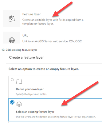

In ArcGIS Online  add a new item.
Choose Feature Layer and then choose your existing feature layer that your form is using.

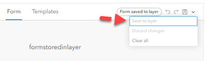

Open the new map in field maps designer.

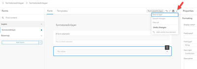

Add one formElement to it, and save the form to the layer.
Note: In order to edit the JSON in ArcGIS Assistant their needs to be something to edit.  If the data is empty the ArcGIS Assistant won't show the Edit JSON button.
For your source map that has the Form that you want to use with a new layer, you need to make sure that you have saved that form to the layer as well using field maps designer.

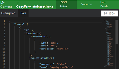

Use ArcGIS Assistant to copy the formInfo from your source layer.
Select formInfo and copy.
Then open your new layer in ArcGIS Assistant, Edit Json on Data tab,  Remove the formInfo and Copy in the source formInfo, and save.

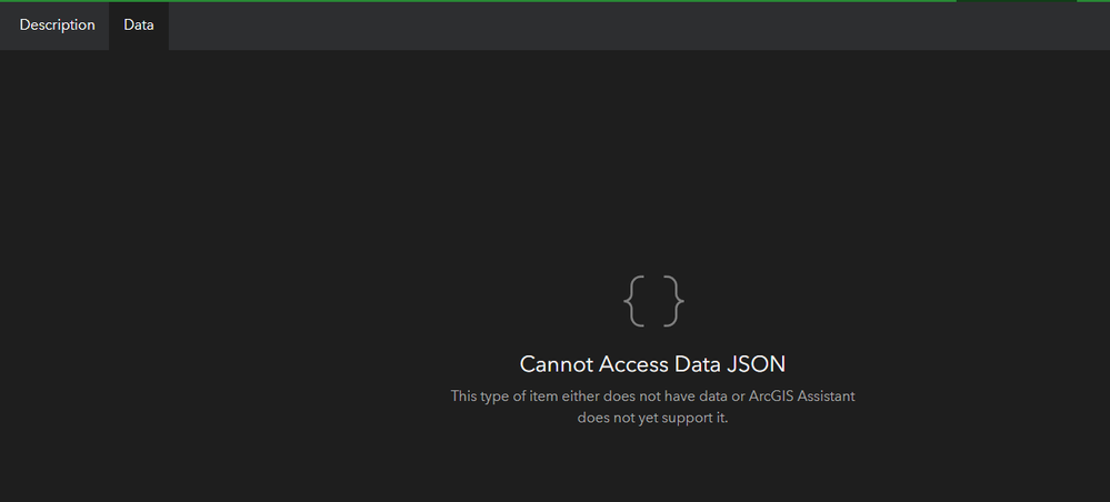

When I do the steps I get this at the point of "copy in the FormInfo into the new layer...

Oops.. I missed a step.
Add your new layer to a new webmap and save it.
Open the new webmap in field maps designer.
add one form Element to it.  (info or group would work)
Then Save the form to the layer.
Refresh ArcGIS Assistant (if you already have it open)
Open the layer...
and the Edit JSON button will be available on the data tab.

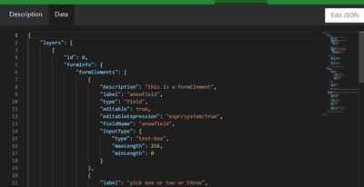

Replace the formInfo with your desired formInfo.
DeanAbrahams
Ok - I appreciate your input and patience. I think I'm almost with you! To copy the formInfo do I just highlight and copy? and then paste like normal things - sorry - I have no experience with JSON and it looks scary to me 😉
Do I just follow the line down - I'm confused as to exactly what and how to copy on this Data tab.
