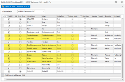

I had this problem with my data and solved it by changing the properties for the required fields so that they do not have the "Allow NULL" option checked (highlighted in yellow). Note that you can only change that property on an empty table.

Yes, when I created the layers in ArcGIS Pro, the 'Allow Null' option is check off for the required fields before I shared it as a Web Map to AGOL.
