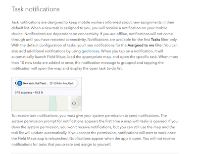

To get task notifications, you’ll need to allow system notifications the first time you open a map with tasks. If you say no, you won’t get alerts — but the task list will still update in the app. If you allow them, notifications will start working after you relaunch Field Maps.
Note: You won’t get notifications for tasks you assign to yourself.

French but looks like they are getting notifications: esri
