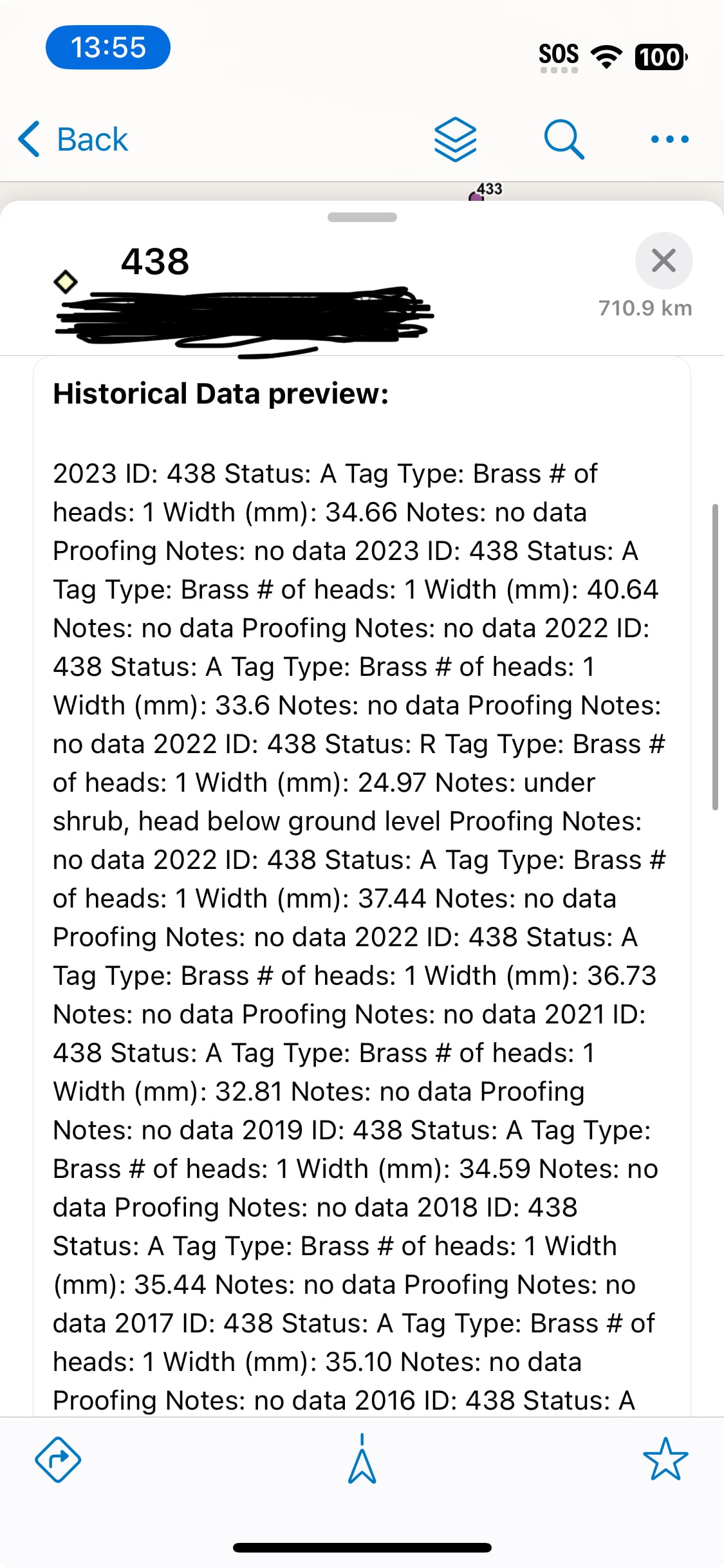

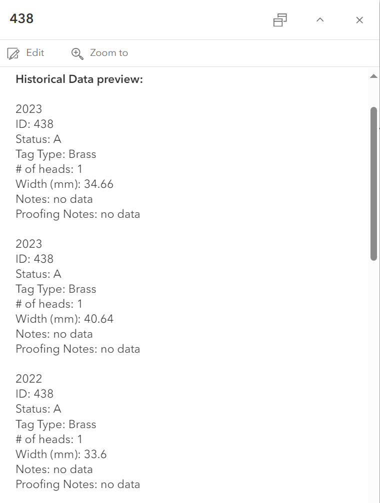

I created popup's for a layer that is referencing a related table. I can get the popup to successfully load and format the data correctly in the web map, but there is no formatting in the Field Maps mobile app (running the latest version of the app on an iphone 13 mini).  I included my code and images of what it looks like in the web map and Field Maps. Thank you! web-map.PNGfield_maps.jpg

Field Maps does not interpret "TextFormatting.NewLine" or "/n" properly. If you want to add them, you have to use the Arcade element in the popup (not text element) and <br>
var test = ['A','B','C'];
var output = '';
for (var i in test)
	output += `${test[i]} <br/>`;
return {
	type : 'text',
	text : output //this property supports html tags
See here for more:
