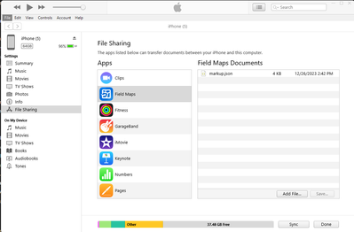

So, I am working through this.  but in the file sharing through iTunes, for field maps, i am unable find the geodatabase file.  can you please help me here.
