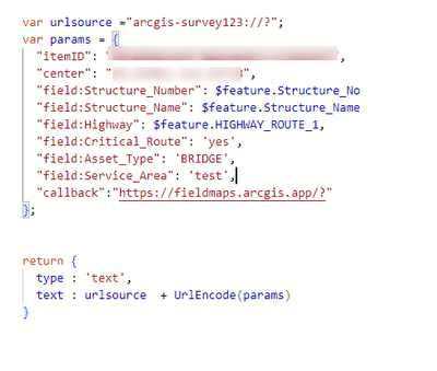

Are you using new map viewer? I would recommend you do. Just note that pop-ups no longer drive editability (it's forms) and this could impact edit multiple.
Can you share your latest code?
