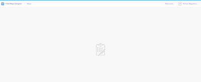

Field maps designer does not work with new maps I have made.
When I open the map in fieldmaps designer the screen is blank.
Normally you would get options to configure the forms etc. But I get nothing.
Is this a bug, should I contact support?

Does the map open properly in new map viewer?  If so, do you get the Form option there?

I'm having the same issue. When I try to open a map made in Field Maps Designer, I get a blank page. I've opened the information page for the map via "Content", then am clicking on "Open in Field Maps Designer". The map will open in Map Viewer, but when I click on the "Forms" button, I also get a blank page.
Strangely enough, when I try to open Field Maps using the app buttons at the top my account page, I also get a blank page.
All worked well previously. Data was collected via Field Maps without a problem. That data shows up when the map is opened in Map Viewer. I just can't access the form to make some edits.
Perhaps Field Maps is just unavailable right now?

Same issue,
also can not open older maps
Adrian_Negulescu
For me, the same task opened in Microsoft edge instead of Google Chrome runs fine, so try to change your browser
MattyMaps
update chrome
