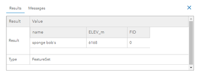

Try substituting an Arcade variable in the SQL def.
var features = FeatureSet('{"fields":[{"alias":"name","name":"name","type":"esriFieldTypeString"},{"alias":"ELEV_m","name":"ELEV_m","type":"esriFieldTypeInteger"}],"spatialReference":{"wkid":4326},"geometryType":"esriGeometryPoint","features":[{"geometry":{"spatialReference":{"wkid":4326},"x":-151.0063,"y":63.069},"attributes":{"name":"sponge bob' + `'` +  's","ELEV_m":6168}}]}')
var name = "sponge bob's"
var sql = "name=@name";
var ffset = Filter(features, sql)
ffset

Testing this in the ArcGIS Playground... I can see the payload escaping the apostrophe.
