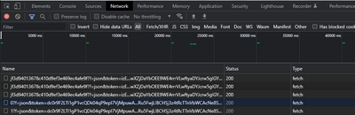

In ArcGIS Online go to create offline map areas. Prior to hitting create, open the browser developer tools and go to the network tab. Hit create.
You will begin to see requests to setup the map area. Then requests to check the update of the job. Look for the repeated request as the map is packaging.
If you open one of these up, and remove the f=json... from the end of the URL request, you can see a more informative update on where job is up to and why it ultimately fails. e.g. URL looks like:
https://packaging.arcgis.com/arcgis/rest/services/OfflinePackaging/GPServer/SetupMapArea/jobs/longjobidstringhere12bdfasdfsasdf
Click on 'packages' to see more on the results. Should give you something to work with. Common reasons you will encounter are:

Thanks a lot for your answer, it was very useful. I was able to open one request file and it pointed me to the problem: my 2 tile services could not export tiles for the lower levels (2,3.. 11) as I created only 12 to 21 (which by the way makes sense for my area).  I'll see what best way to fix that.
