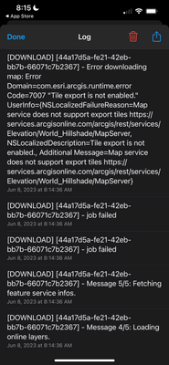

I was able to download an offline area yesterday, then today when I tried to download an offline area it failed.
I removed the hillshade part of the map service and then I was able to download an offline area. Is this something ESRI needs to fix or could I fix it on my end?

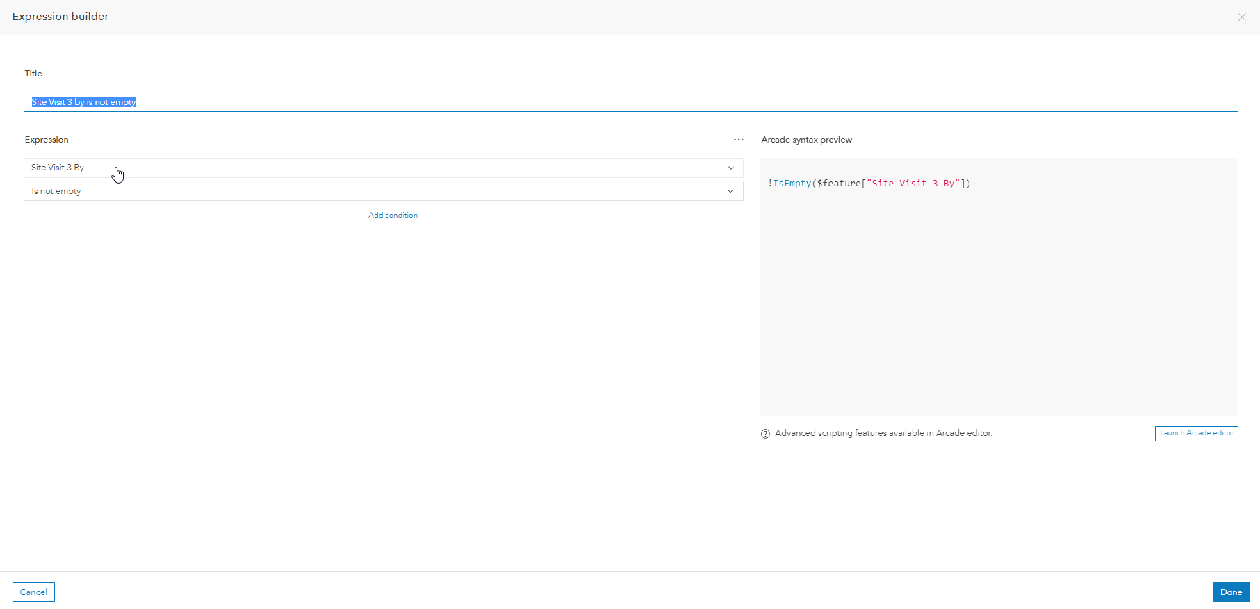

Also, the Field Maps designer was glitchy this morning. My form I created on Monday was gone and the tool switched from Expression Builder to Arcade. Then about ten minutes later the Expression Builder tool was available to use again so I could recreate the form.

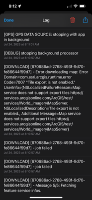

I'm still getting this error:
"Tile Export is not enabled" for the World Imagery MapServer, when I try to download an offline area in field maps.
I had an offline area in field maps using the map server and removed it this morning so I could add one column to my table. When I redownloaded the offline area it failed to download. Sometimes I can download the map using the basemap and sometimes I can't and I don't know why it isn't working.
