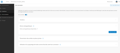

i have quite the same issue, but it's my first use of arcgis field.
when i try to create my  offline map on arcgis fields, it gets to about 10% downloaded and then just pops in with an error 'download failed' and when i try to create the mapping area in here (the picture below) it fiels too.
do you have any idea of the problem please.
