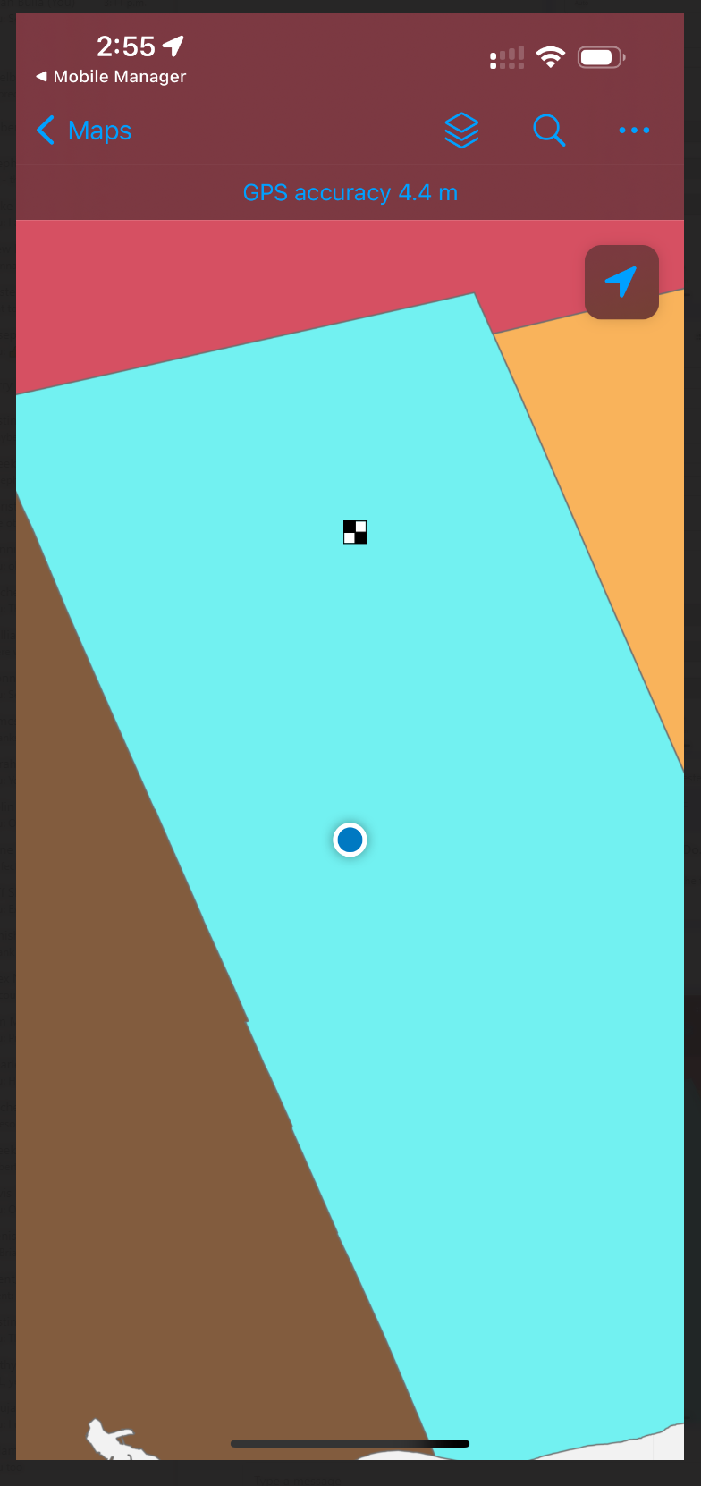

Hi.  I've created map in AGOL for use in Field Maps.  My collection layer has editing enabled, but in Field Maps I am not able to create a new point.  What might be going wrong??
Here is a screenshot showing the map.  The one point showing here was created in AGOL, so I know editing is enabled and working.  I have my collection settings set to 10m accuracy, so that shouldn't be an issue either.
Any ideas??

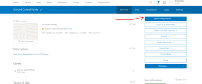

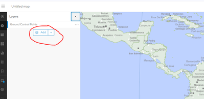

OK, so I finally got this to work.  The weblayer was fine.  I was able to add points to it if I added it to other webmaps.
The issue seems to be related to the workflow....maybe??  I first created the webmap by adding the layer to a map through the "Open in Map Viewer" button.
The fix seems to be to open a webmap, and then add the layer through the "Add" button.  Doing it this way, it works.
