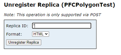

From the service URL page there is a Unregister replica page.  If you give that page a * it will remove all replicas.  You could program this in I think.  So your script removes the replicas then publishes.  This will of course break any sync ability of the user and they would have to take a new replica offline to start sync again (I know no edits but sync also is used to bring in new adds from the service).
Replicas is how the whole offline system works so I do not think you can stop that part.
Hope that helps

Hi Doug,
Thanks for that, yes I am aware of the ability to unregister replicas. Unfortunately it is not an option in this scenario as it will break the sync back process when users are trying to push their edits to the editable layers on the same offline map back up to AGOL.
