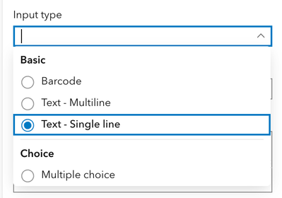

@BrandonGuo this is supported, however, you have to use a workaround.  You're unable to set the Input Type to Multiple Choice when the field is first added to the form.  However, if you save the form and then open it again, when you select that field to edit it's properties, Multiple Choice will be avaiable.
Since this is on a View, your field will need to pre-exist.  In addition, if you want to use the "Other" option, that field will also have to pre-exist.  If it does not, and you try and add the "Other" option, you'll get an error on save.
As to how long you'll have to use this workaround, I can't comment on that.  The team is discussing how best to address it moving forward.
Let me know if this doesn't work for you.
