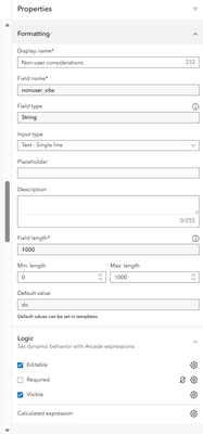

Also having this issue - have just gone to update our workflow, added the new text fields to the layer, gone to add this to the Field Maps form and there is no option to add this as a multiple choice field:
Unable to add as a multi choice option to the form as the field already exists now as a text field.
This is also a hosted feature layer view so you cannot add fields through forms anyway. I added a text field to the core hosted layer, then refreshed the view, now am trying to add the multiple choice to the form.
