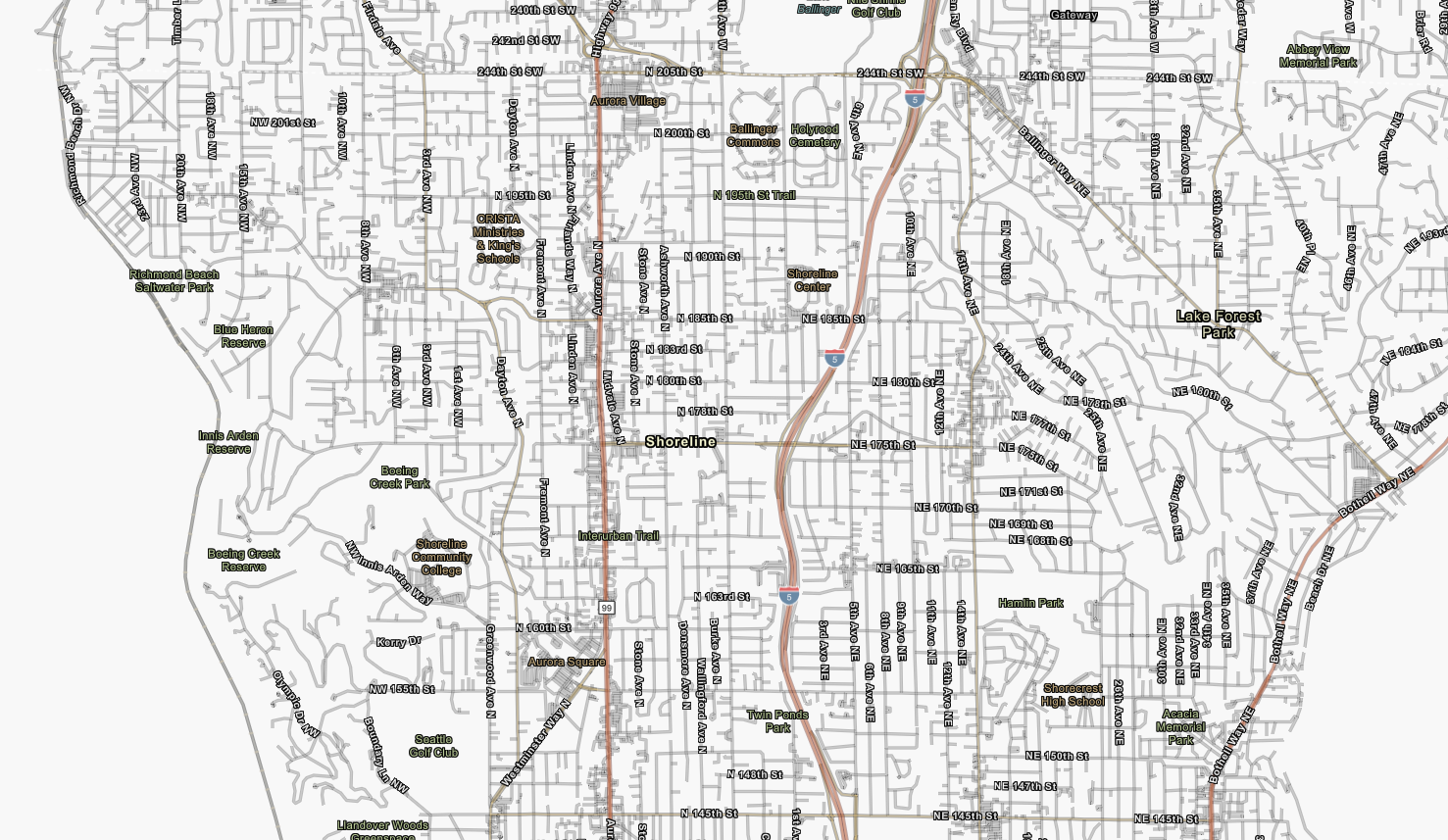

I'm trying to create an item of Hybrid Reference Layer (for Export) in my organization's Enterprise Portal with credentials stored so it can added to a web map used in FieldMaps, offline configured. The issue I'm running into is that when I create a new item from the Hybrid Reference Layer (for Export), it just creates a tile layer for World_Basement_Export_v2:

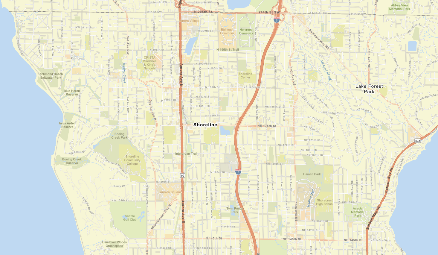

What I want is this:

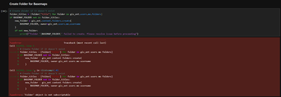

Thanks so much for the reply. I'm running through the notebook, but getting stuck on this part:
Error:
TypeError: 'Folder' object is not subscriptable
Do you know what is causing this? All my credentials are entered correctly.

joycxjc
Update: I'm using ArcGIS Pro 3.7 and Enterprise 11.5. I needed to change a line of code to accommodate updates.
Replace: folder_titles = [folder["title"] for folder in gis_ent.users.me.folders]
With: folder_titles = [folder.name for folder in gis_ent.users.me.folders]
