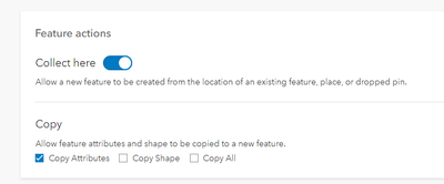

Do the field workers need to be on the feature they are collecting (ie can they use the built in gps as the location for the features)? You can set a required accuracy for the GPS that will ensure data quality in this scenario.
If that doesnt help, the closest functionality I can think of is that we can restrict the use of the "Collect here" button, which can be used to place points at a certain location by long pressing on the map. This functionality can be removed on a per map basis from the particular Web Map in Field Maps Web.

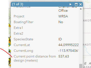

No but you can use a calc in Arcade to yell at them they are too far in red.  Best I could find.

Just convert the formula above to arcade like this
var originShift = 2.0 * PI * 6378137.0 / 2.0;
var lon = (Geometry($feature).x / originShift) * 180.0;
var lat = (Geometry($feature).y / originShift) * 180.0;
lat = 180.0 / PI * (2.0 * Atan( Exp( lat * PI / 180.0)) - PI / 2.0);
return Round(Acos(Sin(lat * PI / 180)*Sin($feature.DesignLat * PI / 180) + Cos(lat * PI / 180)*Cos($feature.DesignLat * PI / 180)*Cos(($feature.DesignLong * PI / 180)-(lon * PI / 180))) * 6371000,2)
It basically calcs the lat, long of the point then compares to the static lat/long they were supposed to go to.
You can then add a if if you want.  Like if distance>5 then return Warning you are too far type message.

Design Lat long is where they are supposed to be.  Prob would be surveying location in you case.  You are just comparing one lat/long pair to the other.
This is all Arcade in the webmap.
