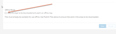

RhettZufelt
MVP Notable Contributor
To get past the Export tiles is not enabled error, Offline mode needs to be enabled in the Settings tab of the Geologic Map of California Tile Layer (hosted).

RhettZufelt

AlfMuseum
Thank you, I can see how that would work, but I can't even create the Geologic Map of California as a hosted tile layer. I'm worried that without ArcMap or Pro that's not possible? More digging to do.
RhettZufelt
By your original post, I assumed it was a hosted tile layer already.
The Geologic Map of California tile layer is added to......
But, both the links you sent are not shared publicly, so couldn't really look at the data.
