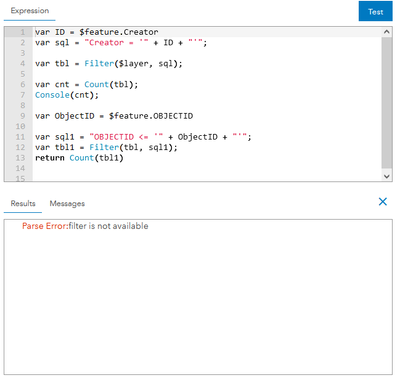

I tried to label each point feature by ObjectIDs so that users know the count each time they provide a new observation. This one doesn't work well because all observations are being stored in the same point layer, so the ObjectID does not indicate the total number of observations collected by the respective user.
I also tried to assign unique observation IDs for each user using calculated expressions. Every time I add any expression, the mobile app doesn't show the form. It says: "the form contains unsupported data".

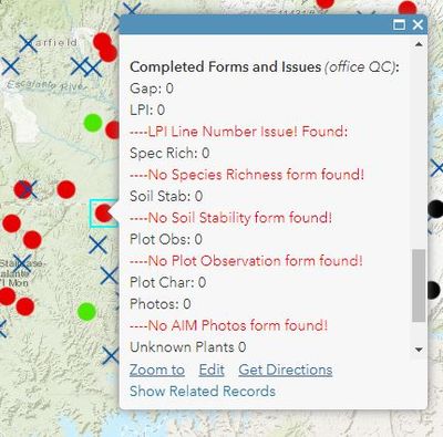

Does each record have the user name in it?  If so you could use FeatureSet in a popup to tell them how many they have done and warn them.
I use this to report missing forms.
Not Sampled {expression/expr32}
var EvaluationID = Concatenate($feature.PointID, "_", text($feature.FieldEvalDate, "Y-MM-DD"))
var sql = "EvaluationID = '" + EvaluationID + "'";
var tbl = Filter(FeatureSetByName($map,"Not Sampled", ['EvaluationID'], false), sql);
return count(tbl)
Hope that helps

Thanks so much for your response. Yes, that helped a lot. I was able to provide a total count of responses and a confirmation of form completion in a pop-up.
The issue is that users have to click on each of the point feature to check out its respective pop-up bar. Is there any option to make the pop-ups appear all time, specially for the incomplete point features?

I tried to symbolize the points based on a unique ImageID, but adding a new expression gives me the following error:

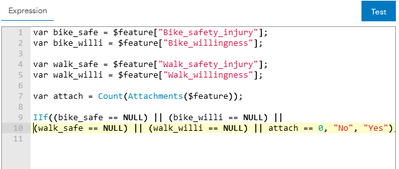

Same goes for checking data completeness. The following expression gives me an attachment error:
Both of these expressions work fine in the pop-up.
