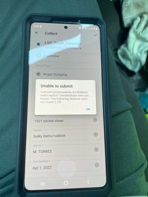

OscarFigueroaOD
Hi
Was there a solution or workaround to this bug.  We are still having the same issue.
Thanks
nspittlemeister_LCFPD
Doesn't seem like the same error that I had at the time. In the case that I had open the layer would not load in Field Maps. It looks like the layer loaded okay with you, but is unable to submit. And anyways, it turned out the bug I listed did not have anything to do with layer loading issue at the time.
Sorry that I can't be of more help.
