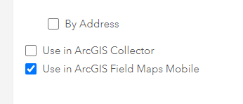

Check to make sure you have it marked to use Field Maps in the settings.

Hello @RobertBorchert, where can I find this setting? I'm having trouble finding it.
JMCM
This is late, but for anyone working with this, it's at the bottom of the Settings for the map's item details on ArcGIS Online as a toggle.
However, I think the original commenter's issue is unrelated to this--looks like there was an issue with migrating domains, even if the domains worked in the original layer. I would temporarily remove domains and see if the layer works after that.
