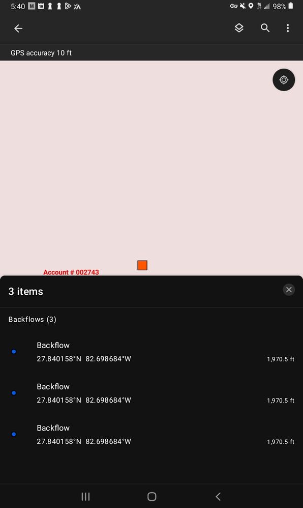

We are working on a new field map for an asset inspection process that allows users to edit attribute data with a custom form. When a user selects records from the map, is there a way to show specific attribute data instead of the lat/long coordinates? We would like the asset serial number to display instead of the coordinates.
Screenshot_20230810-174016_Field Maps.jpgScreenshot_20230810-174016_Field Maps.jpg

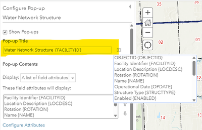

I am not sure about how to remove the coordinates, but you can add attribute data to the pop-up title and it will show up in that list.
In Map Viewer Classic:
In New Map Viewer:
