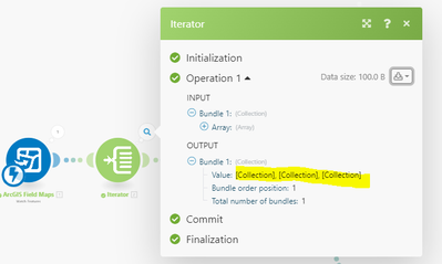

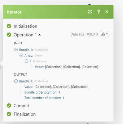

But when have 3 adds only 1 is processed - any help on this much appreciated, thanks Charlie

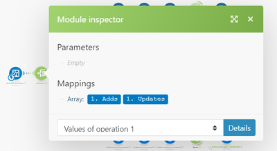

Can you reply with a screenshot of the iterator configuration?
CharlieColey123
Hi Aaron
Thanks for looking
by Anonymous User
Not applicable
As far as I know, the iterator only works with a single array. Right now you have multiple arrays as the inputs (adds and updates). I think you should either create two separate paths using a router or use the merge IML function to properly combine the arrays.

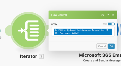

See how this only uses the "adds" array.

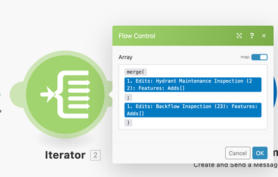

This is an example with merge (untested) which combines to adds arrays. You could change it to adds and updates.
