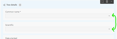

I'd like for the scientific name to auto-populate when a field worker selects the common name for a tree inventory (and vice versa).
1721
6
12-19-2022 10:59 AM
Rusty_Shackleford
I am using Forms in FieldMaps on AGOL to create my form for field data collection for a tree inventory.  I would like for a field worker to be able to select the common name from a combo box drop down and then the corresponding scientific name would be auto-filled in.  Conversely the worker would be able to select the scientific name and auto-populate the common name field.
I have not been able to come up with a way, any suggestions would be greatly appreciated.
Thank you.

Yesterday I used your example to create an expression.  I chose to try to create the expression to pull the scientific name when the common is selected.  After playing around with it, it looked like everything was good to go, but I didn't have a chance to actually try it before getting called off to something else.  I apparently didn't save it.  This morning I entered everything in again and I am getting this error:
"Execution error - Line : 1, 7: Call with wrong number of parameters"
return Decode($feature["commonname"],"American snowbell","Styrax americanum","Arborvitae","Thuja spp.","Black tupelo","Nyssa sylvatica","Black walnut","Juglans nigra","Bottlebrush","Callistemon spp.","Camphor","Cinnamomum camphora")
I shortened my species list for posting, but this is what my expression looks like.  As far as I can tell my code matches yours.  Any chance you can spot the issue or know what the error is indicating?  I apologize, I am a novice at this part.

Thank you the missing default value was the problem.  But now I am realizing that this solution isn't exactly what I was looking for.  It may be that it is the best I can do for now.  Because the calculated field (scientific name in this case) is read only, it doesn't work both ways.  I wanted the field worker to be able to choose whichever name they know best, common or scientific, and the other would auto-populate.
Thank you for the help.
