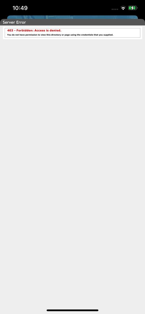

We have Field Maps installed and registered on Portal.  We have it for both iOS and Android.  However, none of the iOS uses can log in (the Android users can); the moment they add the portal url, it comes up with a HTTP 403 forbidden error.
This also happens with Workforce too.

I am going to the application and entering the url to our Enterprise portal as so: https://url_to_portal/arcgis/
I am not even getting to the sign on page.
I can log into the portal via Safari or Chrome on iOS
Probably worth reiterating that the Field Apps for Android loads properly, so it's likely the iOS is doing something it's not supposed to be; for further information, we have WAF setup as a part of the Azure Application Gateway which scans the incoming requests

Based on this - I'd think the place to start is with your IT group, and have them review filters that they may have applied to the WAF which might be blocking the incoming call from Field Maps. They hopefully would be able to see if the call from FM on iOS is being blocked.  Different filters may be coming into play b/w iOS vs Android depending on the configuration.
