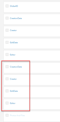

I tried publishing the web layer of the 500 points but that didn't work because it created a new global Id field and new editor tracking columns and it quit using the old columns when I added points. (The staff use these fields to generate letters to homeowners so I wanted to keep those fields the same).

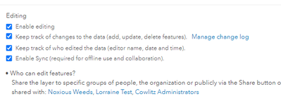

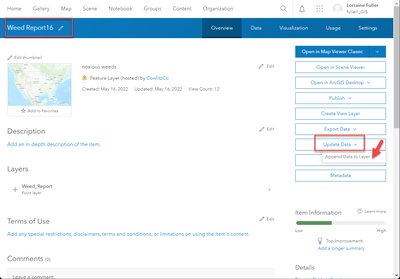

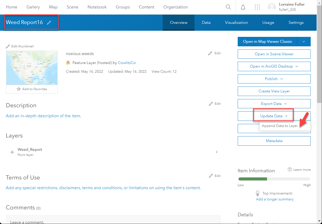

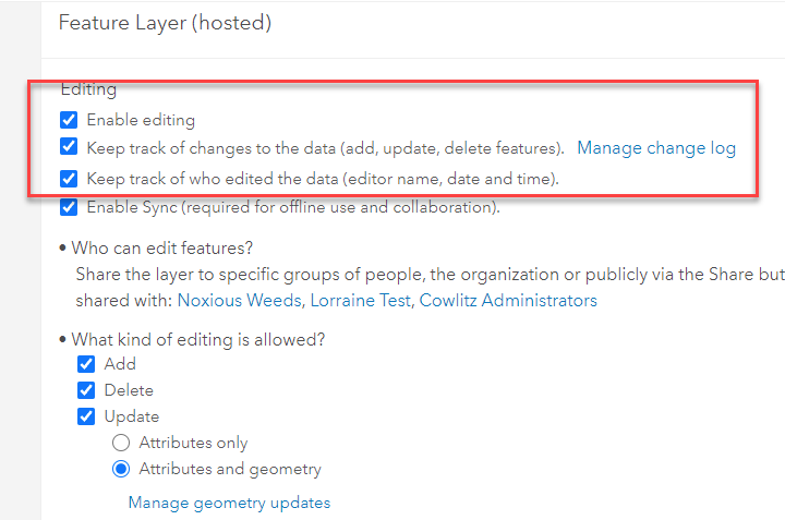

I put a test point into ArcGIS online and turned on these settings, then I used the append data button to add the 500 points. This worked for getting it to use the current global id field and the current editor fields, but somehow it shows me as the editor for everything, instead of the field workers, and the photos don't show up.

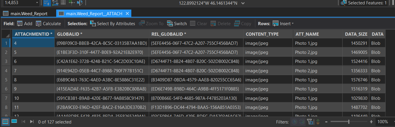

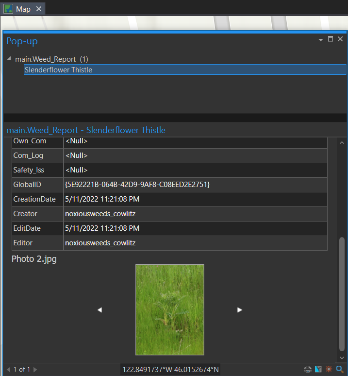

In ArcPro I can see all of the 500 points in the feature class, and the 130 photos in the Attach table and if I click the info button on a point the photo is visible.

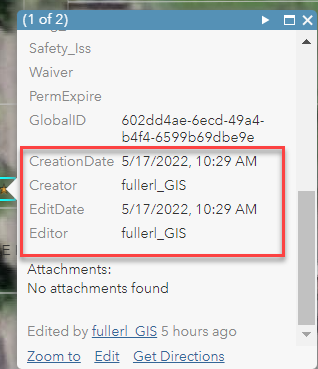

It shows me as the creator and editor:

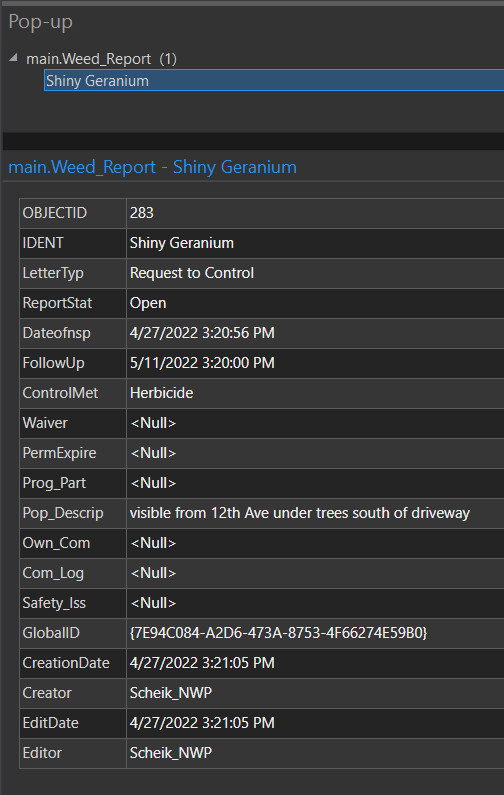

This is the actual data from before with the real editor:

Maintaining the editor tracking information is relatively easy, just turn off "Keep track of changes to the data", append the data, then turn it back on. All the original tracking info will be there.
Concerning getting the data back into the service, I would try to append the data from ArcGIS Pro. The environment setting for this tool has a "maintain attachments" option which should work. You might need to convert your mobile geodatabase to a file geodatabase for this to work. Note editor tracking should also be disabled prior to this if you want to maintain the original editor tracking info.

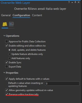

Another approach would be to override the service with "Overwrite Web Layer" and keep the option  "Preserve editor tracking info" enable.
See image below
Cheers
Stefano

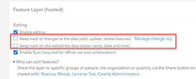

Now the only issue I have is that when I publish it even though I have the preserve editor tracking turned on, once it is published editor tracking and track changes is off by default.

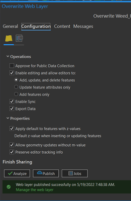

My settings when publishing:
If I check the boxes to add the track editor and track changes then it adds new columns instead of using the existing columns for editor and track changes.
Do you know what settings I should pick so it will use the existing editor columns?

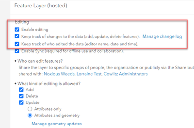

With option "Preserve editor tracking"  in ArcGIS Pro, you can leave check "Keep track of change..." on in ArcGIS Online. And enable Editor tracking in feature class
Cheers
L77
I tried that and when I change the settings in the catalog pane to enable track changes for the feature class, it immediately creates the 4 additional track changes columns before I publish the data, and it shows me as the editor. I tried using the field calculator but the new columns are locked.
I can't seem to find a way to make the existing creator, and editor columns and data columns the ones that will populate the new data.
