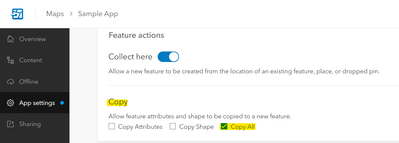

I understand this behavior may be caused by the settings in the Field Maps web app:
Depending on the copy settings configured in the Field Maps web app, you can choose from the following options:
  • Copy attributes—Copy the feature's attributes to a new feature.
  • Copy shape—Copy the feature's shape to a new feature.
  • Copy all—Copy the feature's attributes and shape to a new feature.
Configure the map—ArcGIS Field Maps | Documentation
Could you please check in the web app to see which setting is used? If Copy All or Copy Shape is used, the Geometry should be copied. Please see if this works for you.

3. Go to the Field Maps web app, open the map, click on App Settings, and check the "Copy Shape" box and uncheck "Copy Attributes" and "Copy All" options.
