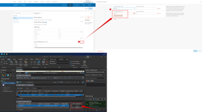

I am unable to use a field which has the same "Description" of Coded Value Domains in ArcGIS Filed Maps Designer. Does anyone know that this behavior known limitation?
I am unable to use my existing data, so confused...
Steps:

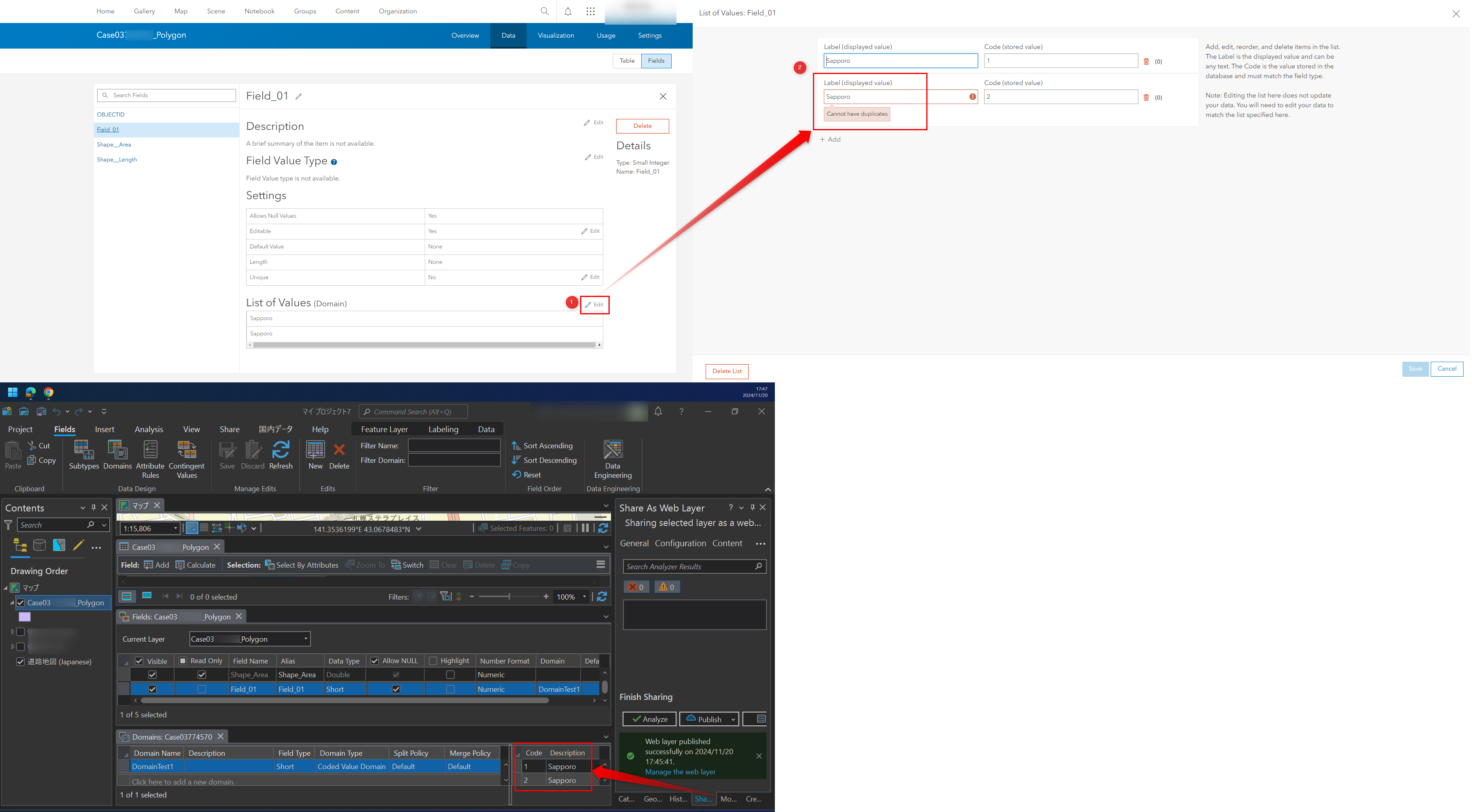

  1. Set two Coded Value Domains which has the same "Description". Ex. 1: Sapporo, 2: Sapporo
  2. Share it to ArcGIS Online as a hosted feature layer.
  3. Open it in the item detail's page and check its domains. The message "Cannot have duplicates" is displayed in Label (displayed value).

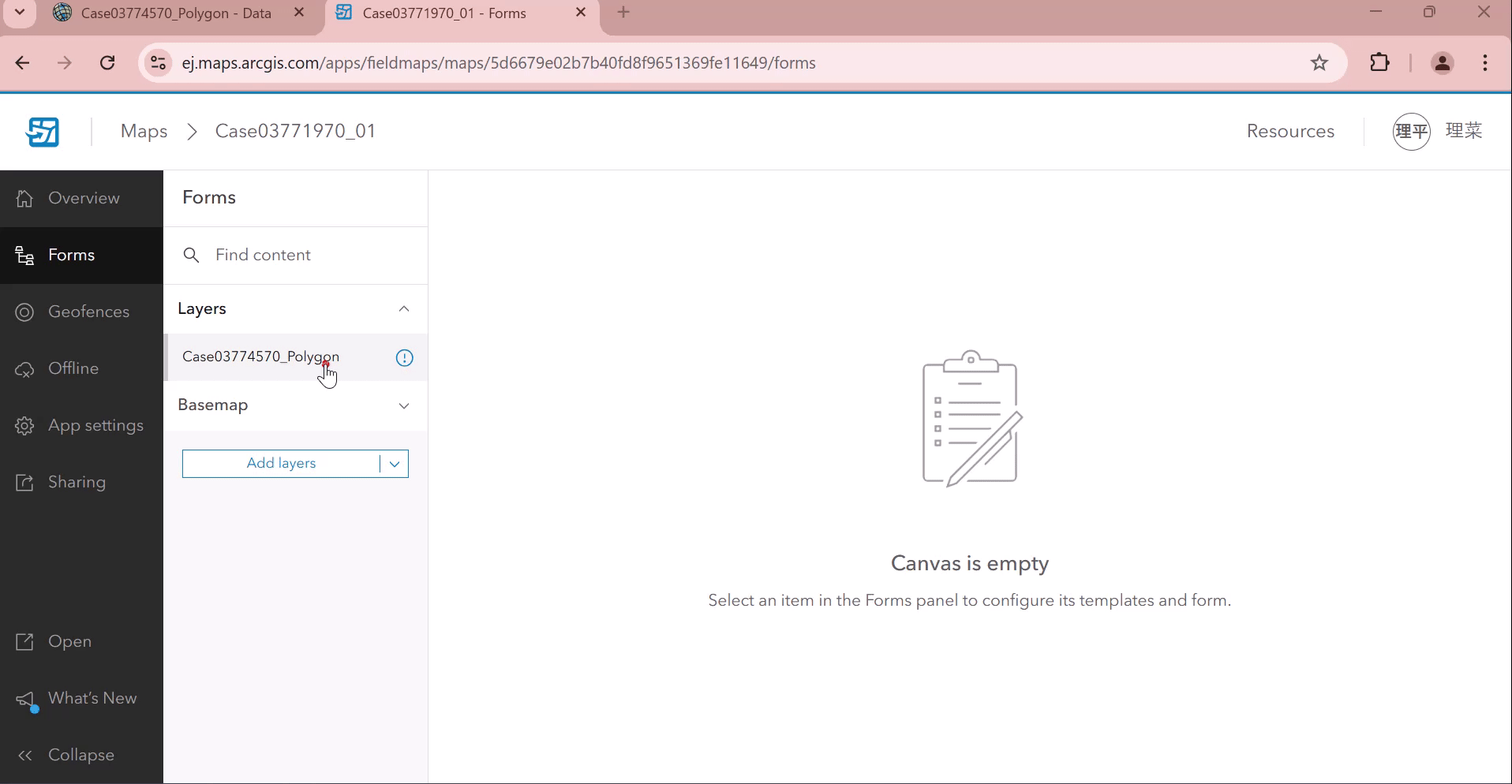

  4. Open it in ArcGIS Filed Maps Designer and put it into a form. The message "Unable to save your form changes. The form contains invalid properties or an error has occurred." is displayed.
Thank you in any advices,
hitsujir_dev
