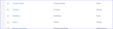

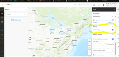

Another configuration would be to enable editor tracking in Map Viewer, which I believe adds the fields: [Creator, Creator Date, Editor, Edit Date] to your feature layer where you want to add/edit features. These fields populate from signed in AGOL or Enterprise Portal user credentials.    After you enable editor  tracking, to add the fields,  you can then configure and utilize the fields in Field Maps Designer form view and elsewhere.
