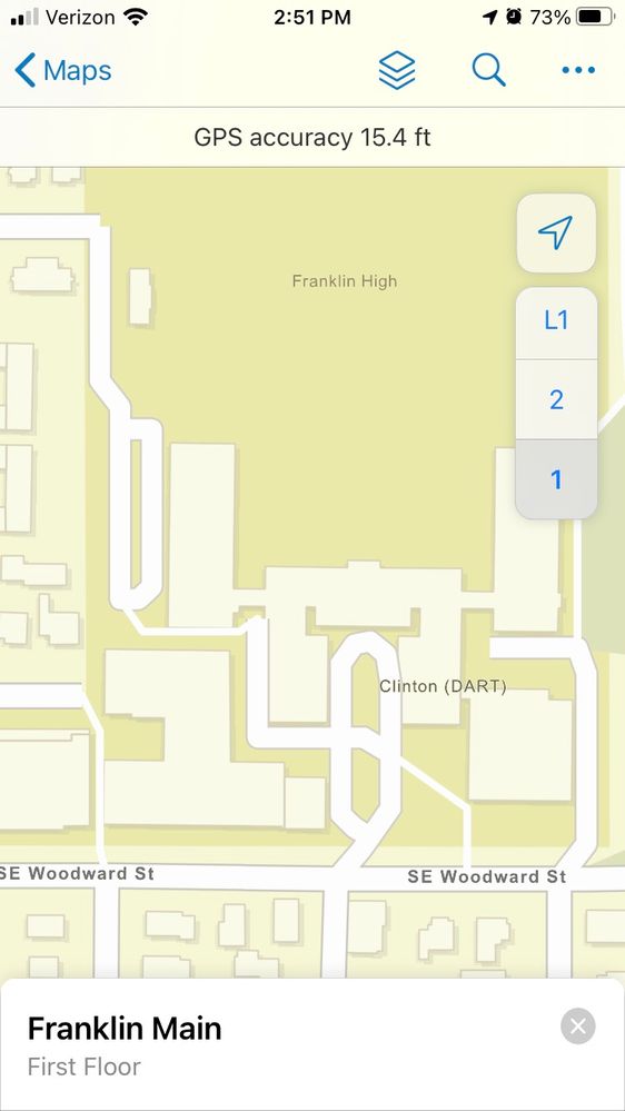

Here is the high school. I can see the first floor for a second, and then it disappears. Even after choosing different floors and toggling the layers on and off, I still can't see the floor plans.

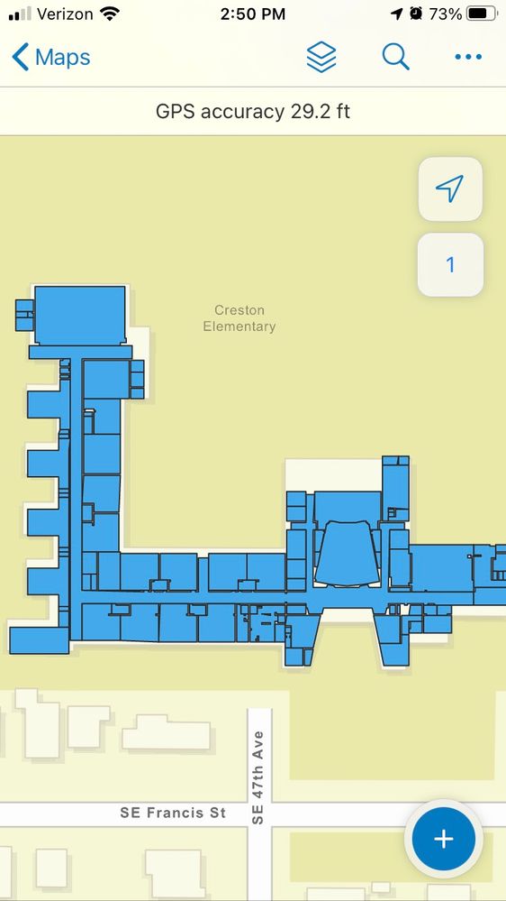

And the elementary school. The first floor plans are visible as soon as I navigate to the site.
