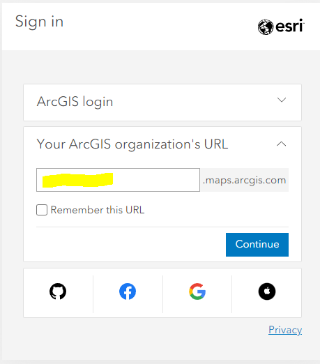

I'm hoping that the issue I'm having is just user error and has a really simple answer. My organization uses Fieldmaps for various reasons. We log in using our organization's URL:
On the tablet we are using, if you sign out and then try to sign in as a different user it auto logs back into the previous account. There is no option to type in a different email/password.
The limited information I've found on this says to clear your cache, but I feel like there should be a more straight forward way to change the user.

The issue is that after signing out, when I try to sign back in as a different user, it doesn't give me the option to use a different email. It just re-signs in as the previous user.
