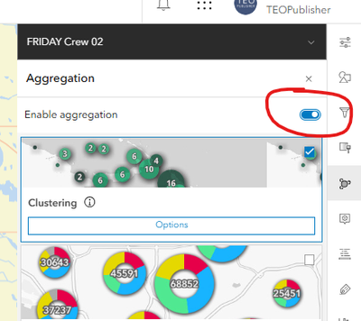

I figured it out.
The layer that was not working had 'aggregation' enabled. As soon as I disabled that functionality the layer works again.
It's very frustrating though that ESRI's software updates continuously break current functionalities, and it's up the customers to figure out the fixes.
ColinLawrence
Thanks for reporting this. With clustering on you should get a different type of popup, a Cluster Summary popup. Are you seeing this popup where you have areas of multiple features close enough together where they are clustered in the UI? For some reason, popups for single features are not being returned when aggregation is turned on in the Map. The team will look into this.
