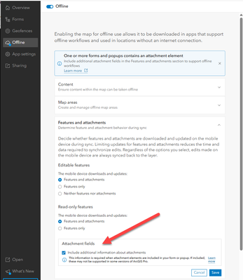

There is a new attachment fields setting that goes along with the feature attachment elements in the form authoring.  Take a look at it.  When enabled the feature attachment elements in the form should work offline.

Thanks! This worked. Is there a reason this is not enabled by default?
Adding words for the next time I google the same thing to have this forum appear:
What previously said "the form contains unsupported data" in the offline version now works.

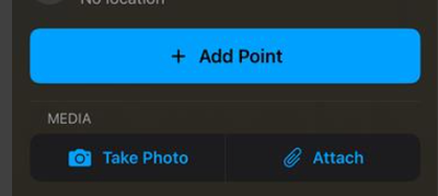

Before checking the box, this is what my offline version showed when trying to add data:
After checking the box and creating a new offline area. This is the attachment showing in my offline version now!

Hi @laurentideicesheet , the same tick box is available in the Item Details > Offline Options page for the Web Map so you should not need to open FMD if that is not typically part of your flow.
