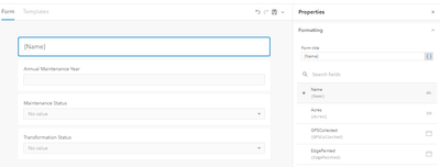

Benjamin:  Did you ever get an answer to your question?  I am having the same issue.  The same field works when I use it for the popup title but not when I try and make it the title of the form.

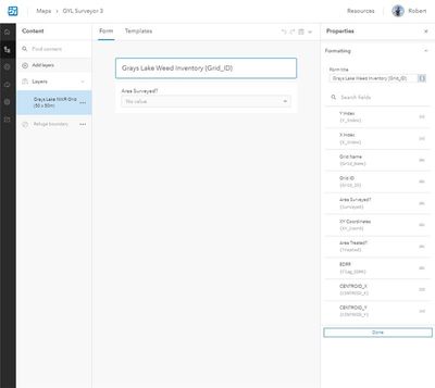

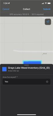

Hi Benjamin.  I am having the same exact problem!  Screenshots below show (1) how the form title was set up in FM on the browser and (2) how form title is displayed in Field Maps for iOS, i.e., instead of displaying the value of the field Grid_ID, it shows "{Grid_ID}" in the form title.
Esri: Is there a bug logged for this???

I found that the fields in the title had to also be somewhere in the form for the values to be displayed.
PaulDavidson1
Nice catch!  I was having the same issue, {address} was not showing in the title of the edit form.  Adding it to the form and then making it read only and not visible left it just on the title line, where I wanted it.
