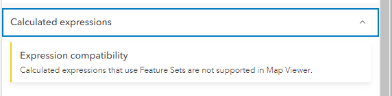

Form?  Are you pushing it to a form?  I am not sure at this point I think you have a misspelling or the workflow is off.  Hard to tell anymore without access to the project.  You can PM me if you like.
Lindsay
Hi @DougBrowning , Yes, what I'm trying to do is write the Block_name from the Blocks layer into the another layer via a form in MapViewer. Similar to what Aaron has done in Point 1 in his article. I've PMed you.
DougBrowning
MVP Esteemed Contributor
Turned out she was in a map not Field Maps and it says in there that is a no go.
Lindsay
Do we have an idea of when FeatureSetByName is going to be available in Map Viewer?
