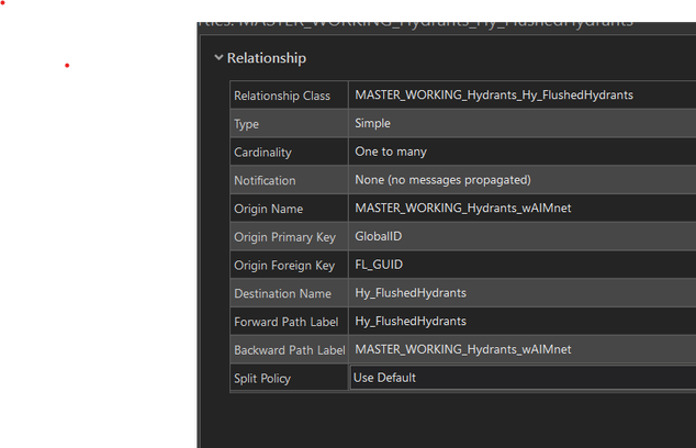

I have a hydrant inspection feature layer with 5 related tables hosted on ArcGIS Online. One of the tables is giving the error in the title. All relationship classes are setup as shown in the picture but this is the only one giving an error. Any ideas what this would be?

KerriRasmussen
Hi @RobynSnookCCB . When you try to submit the form for that specific table, are there any fields highlighted showing which field is causing the error? Or do you happen to be using an Arcade expression on any of those fields? If so, it's possible there is something wrong with the expression were it can't run properly.
RobynSnookCCB
No field gets highlighted, there was some arcade as a calculation and title in the form and pop-up, even after removing it, it still won't submit. I have arcade with the other tables to which are working fine. Thanks though.
I republished as another feature service and it works fine but I'm hoping to fix the original so I don't have to re-do a lot of work.
