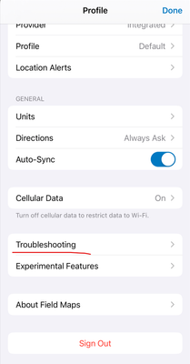

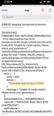

Have you had a chance to look at the logs in FieldMaps? You can get there by going into your profile -> Troubleshooting -> View Logs
The logs might be able to show where the problem or what the problem layer might be.

1) Keep your field names less than 32 characters. We have learned that AGOL does not impose this limit but when you try to create an offline map it tries to create a database on the phone and it fails because the database doesn't support field length more than 32 characters.
