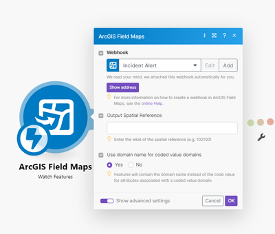

So I've set up the Field Maps/Gmail notification webhook. For some reason the emails have started displaying the domain codes instead of the labels. For instance I'm getting an email with the subject line "Incident at 248." It should read "Incident at Faubion". It has also stopped logging reporter/user names. I haven't changed anything in the scenario and I have "Use domain name for coded value domains" checked yes in the Field Maps module.

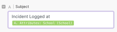

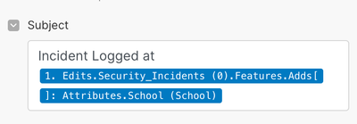

In your Gmail module for the subject I notice you make a reference back to the Watch Feature module output rather than the iterator.
I think you might want it to look like
As well you probably want to change the references in the Content section as well.
I dont know for sure if this is the cause of your issue, but it would be good to make the change and test again to see if the problem still happens

Hey, I tried this and it didn't change anything. It's still printing the site ID instead of the school name. I also have an Arcade expression in the Field Maps form that calculates the reporting user's full name from their AGOL user name. This is coming up blank.
LeviCecil
I've replaced all the content section references to the iterator attributes and the issue persists. It seems like the "Use domain name for coded value domains" button on the Field Maps module isn't working. Below is what I'm seeing in the email from Make. Facility should be "Creston" (domain name) not 243 (coded value).
