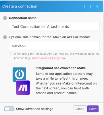

Using the Survey 123 Make module is a similar process to Field Maps, but there are a few small differences.

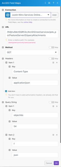

You can use the Field Maps Make an API Call module, to queryAttachments.  The module will take care of generating the token for the connection.

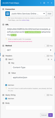

For a connection similar to below, where a sub-domain has been specified, you can then use a Make an API Call similar to the second image.  This will return a list of attachments for the specified feature, which you can then iterate through and make a second API call to retrieve the attachment data (screenshot 3 below) which you can then use.

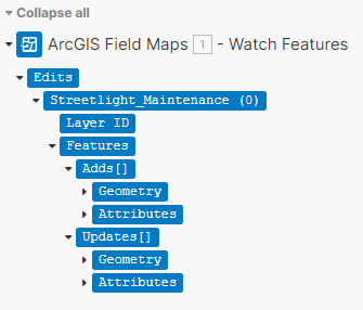

LeviCecil
Is it in the road map to just make the attachments visible in the attribute list in the Field Map watch features module? It would be nice to include these in emails all within the same scenario.
