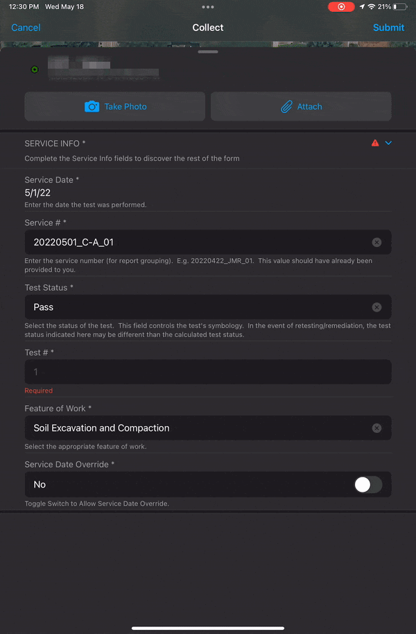

Below the service date is tied to a switch (case 1) and the service number field is tied to itself (case 2). Both are calculated fields and not editable by default.  For case 1, the switch toggling from yes or no determines a true or false return in my editability expression.  In case 2, my editability expression determines if the current field is null, if so it returns false, if not it returns true and along with it enables or disables the field calculation... unless I null the field again as I do below... then the process is retriggered..  This means both of the fields are dynamically calculated and editable and will never be submitted as null. I refer to these cases as dynamic default values when I need them to calc on insert but be editable there after.
Calculated Default Values ExampleCalculated Default Values Example

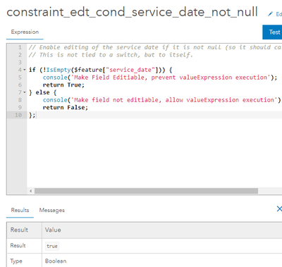

I am still having some issues implementing this. I have attached some screenshots for you 1)the conditional visibility arcade expression, 2) the name of the expression, 3) the JSON in AGO.
I believe I have implemented it the exact same as you. Note I tried both "expr52" and "Conditional_True_False" and neither worked. What am I missing?

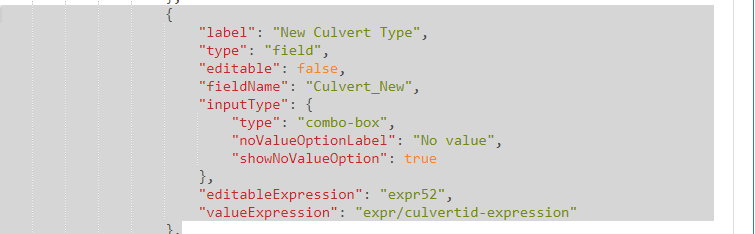

First thank you for the continued help. Please find attached bellow the JSON code I have. In addition, the editableExpression I created (which is a copy and paste from yours).. is not set to any field.
"label": "New Culvert Type",
"type": "field",
"editable": false,
"fieldName": "Culvert_New",
"inputType": {
"type": "combo-box",
"noValueOptionLabel": "No value",
"showNoValueOption": true
"editableExpression": "expr52",
"valueExpression": "expr/culvertid-expression"
The field that is being calculated is "Culvert_New". The value expression i.e. expr/culvertid-expression.. grabs information from another layer regarding a culvert type. The editableExpression is the one I copied from your code in a previous reply.

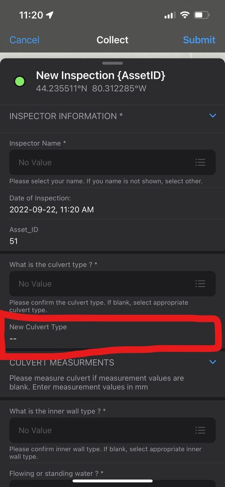

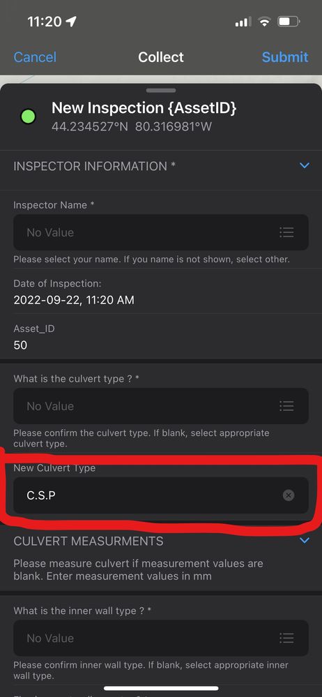

Currently, When I select a culvert that has a culvert type information for (from my other layer).. this is what comes up. The Culvert type shows ... but it is editable (not the biggest deal that it is editable.. but it would be better if it wasn't).
Then in a situation where I don't have Culvert Type information (from the other layer I am pulling from).. it comes up with a non-editable field. I was hoping here... this is where it would recognize the null and then make it editable so they can select the culvert type. I believe I have implemented it wrong because what you have proposed sounds like the exact solution I am looking for.
