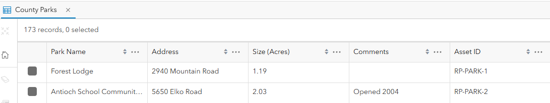

I have a field called Park Name in my form and the user selects the park from a list of options.
I have another field called Parent_Asset_ID.  The asset ID's have already been assigned and each park has a parent asset id.  Instead of the user having to pick this, I would like the field to fill in automatically based on the park name they selected in the previous step.  How can I do this?  Where would I have to put the list of Parent_Asset_ID's? I did all the parks layer to my field maps and the asset id's are in there.

CJCowardin
I think I can use this example in my field maps app but just need help changing the information to fit what I have. If someone could help, that would be much appreciated.
Example:
// Create a feature set using the 'Regions' layer in the map
var regions = featuresetByName($map, 'Regions', ['name'])
// Intersect the current location with the regions and
// get the first region
var region = First(Intersects($feature, regions))
// If the current location does intersect a feature,
// return the name of the region. Otherwise, return null
if (!IsEmpty(region)) {
    return region['name']
} else {
    return null
The feature class in my map where the info would come from is County_Parks
The field with the information is Asset_ID
