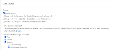

Hey @GISDataTasPorts
If you've uploaded all of your layers as one feature service, you may need to reupload as two feature services, one with the ability to edit and one with the ability to delete, once uploaded, you can change the settings in the Feature Layer settings and change the editing like this here:
This would allow you to only enable deletion on a single layer.
Cody
