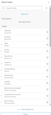

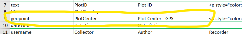

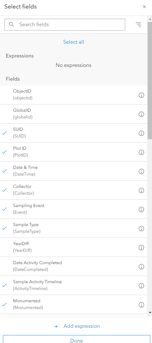

I'm working with a Survey123 results layer (view).  I would like to add the lat/long-goepoint location data to the field list in Field Maps.   I notice that when I try to select the Field where the GEOPOINT data is recorded by the user {PlotCenter} this data field is not availble in Field Maps.
How to add geopoint location from survey to Field Map field list?
My intent is to call on the features (survey point) location data Lat/Long, to inform a new survey to use the same location data.

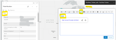

I may not completely understand your workflow, but I still think mode=copy would get you what you want.  Without doing the Arcade button in Field Maps, you should be able to do this more easily in a pop-up in your web map.  In your initial post, you said:
Ultimately using a Pop-Up link link this:
https://survey123.arcgis.app?itemID=a544e9f859e74716a96d143cbdc0c938&field:SUID={SUID}&field:PlotID={PlotID}&field:PlotCenter={PlotCenter}&field:DateCompleted={DATE_COMPLETED}&field:SampleType={SampleType}&field:TransectAzimuth={TransectAzimuth}
I'm not sure if this is exactly what you're looking for, but try this:
  1. in your web map, configure pop-ups on your survey results layer
  2. add content > Text
  3. paste this url
    1. https://survey123.arcgis.app?itemID=a544e9f859e74716a96d143cbdc0c938?mode=copy&globalId={globalid} (if using survey from ArcGIS Online)
    2. NOTE: use &mode=edit&globalId= If using a survey from ArcGIS Enterprise. (This should include the portalUrl parameter before. Ex.  https://survey123.arcgis.com/share/<itemID>?portalUrl=<portalUrl>&mode=edit&globalId= )
  4. highlight and Cut this text
  5. type a friendly name for the hyperlink (example:  "Copy this result")
  6. highlight that friendly text and click the link button
  7. Paste the Cut URL
  8. click OK
  9. drag the text pop-up element to the top of your pop-up
This will create a clickable link in the pop-up of whatever survey result your click in the map.  It should open that result in COPY mode, effectively copying the location (and all attributes) to a new survey result upon submission.  If new results are on null island (0,0), ensure the geopoint question is visible in your survey, and read-only if you don't want the point location to be editable.

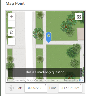

Thanks for the help with this one.  FYI, at least in a survey in a web browser, readonly does work on geopoints.  If my memory is accurate, the map did not respect the readonly setting in the Survey123 Field App, which is one reason we switched to the web.
Are you also saying you HAVE had success with formulas in the readonly field?  I feel like I didn't have any luck a few months ago, but maybe I'll retest.  I also had tried the various ways of hiding the map question (appearance, esri::body::visible) in certain cases for copy mode, but it always put my new point at (0,0).  We have 2 version of our survey, one to submit new, and one to edit, and the map is readonly in the Edit form (where we provide a link for the triage team to copy, if desired).
