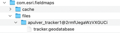

If you plug the tablet into a computer you can transfer files from it. The mobile geodatabase will be in Android -> Data -> com.esri.fieldmaps -> files -> {User-Org} -> tracker.geodatabase.
You should be able to open this geodatabase in ArcGIS Pro.
