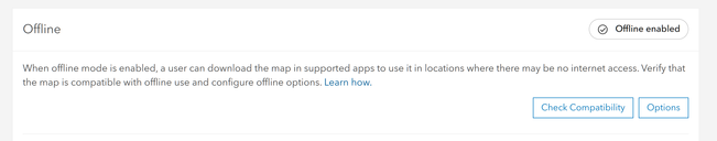

DougBrowning
MVP Esteemed Contributor
The settings tab of the map in AGOL
