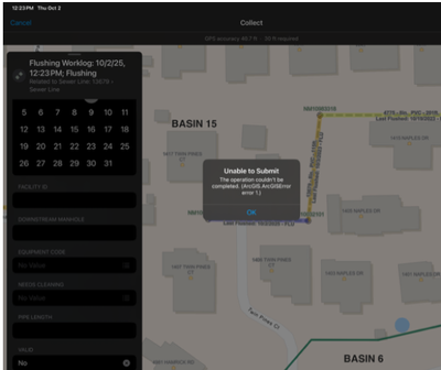

Is anyone else experiencing an issue where you get an "ArcGIS.ArcGISError error 1" when you try to submit an edit on a feature that has a related item? This was not an issue in past field maps versions and just started happening when the field maps app was updated.
We are currently running ArcGIS Enterprise version 10.9.1.

Yep, we're getting the same error.  The weird thing is that the records are actually submitting and the attribute rules seem to be populating, but it's not visible on the map until we close it and reload it, then it appears.  It's upon submission of a related table entry, and it's the same code that you're getting: ArcGIS.ArcGISError 1
UN version 7, 11.5 -- was working fine until today with the update.

@DavidForbuss1 Yes, we see the same thing where the edit still commits and the attribute rules still fire - provided the user backs out of the edit and agrees to proceed with discarding edits. I have a support ticket in place now.

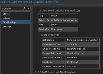

@ColinLawrence I've received the error both while conducting a simple attribute edit on the parent feature (water meter point layer) and while trying to submit a child record in the related work history table. A record is technically added to the child table after the user agrees to discard their edits on the related table. The edit still commits, a new table record is created, and any attribute rules that are supposed to fire are fired. The relationship type between the water meter layer and the work history table is simple, the cardinality is one to many, and the keyfields are: GlobalID (origin primary key) and Related_Asset (origin foreign key).
All of this was working the day before the Field Maps app was updated and has been working for the past 4+ years.
