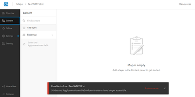

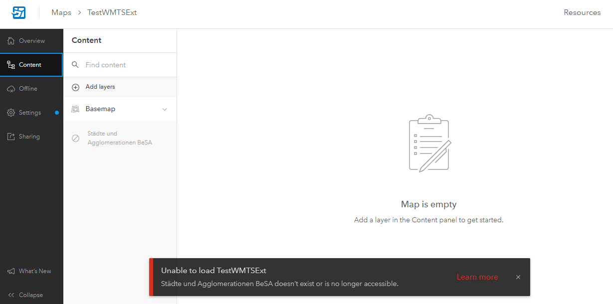

Problem: Error encountered when WMTS layer is added to Webmap and accessed in Field Map in ArcGIS Enterprise v10.9.1
Steps to reproduce in ArcGIS Portal v10.9.1
  1. Open a new webmap and add WMTS layer
  2. Save the Webmap

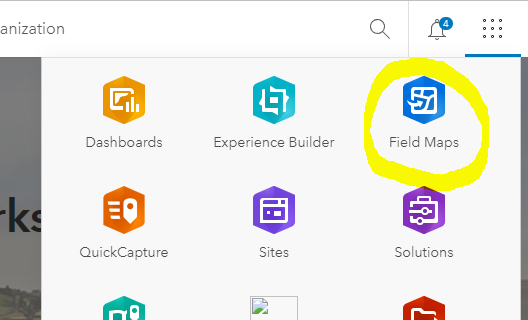

  3. Open ArcGIS FieldMap from apps tray

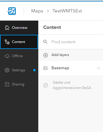

  1. Select the webmap created in step#2 to configure
  2. Select ‘Content’
  1. Below error appears:
Additional note:
  1. The WMTS layer appears fine in Webmap without any error. I am the admin so access is not an issue
  2. This error did not appear in v10.9 and appeared only after upgrading portal to v10.9.1
  3. WMTS URL to reproduce(pls note this one I found on internet. cannot share the one we used). This seems to be irrespective of which WMTS sample service we use
https://wmts.geo.admin.ch/EPSG/2056/1.0.0/WMTSCapabilities.xml

This is an issue we have in our backlog to address for the Fall Online release of Field Maps. That will mean it will be addressed in the 11.1 release of Enterprise. This issue is also logged with Support under BUG-000149211; you can contact Support or your Account Manager to have your account associated with the bug to receive updates.

Short of reverting to a prior release of Enterprise, there is no workaround for this in 10.9.1 and Field Maps.
