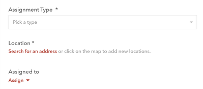

In Workforce, I can create an assignment by searching an address and the location gets auto populated.
I want to do the same in Field Maps Tasks — create a feature by searching an address so the location is automatically filled.

I added a Property Owner field and a Location field and then I used an Arcade Expression to pull the data from the underlying parcel.
However, it is not as clean as I think you would like it to be. In my case, the user has to first place the task icon in the parcel before it will pull in the data.

I’m trying to avoid manually placing the point and achieve something like Workforce, but it looks like that isn’t possible. Your Arcade approach for auto-filling attributes is still useful

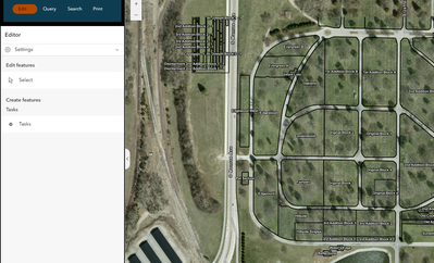

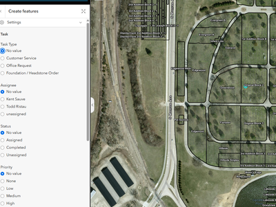

We do not currently have a video demo illustrating managing tasks with the Instant Apps Manager template but we intend to do a Tips from the Team video on that. Meanwhile, I can highlight the key functionality in the Instant Apps Manager template that Workforce also had:
  • Ability to create, edit (including assign), and delete individual tasks
  • Ability to batch create, edit (including assign), and delete tasks
  • Ability to see a map and a table view of the tasks
  • Ability to sort and filter tasks based on various criteria like due date, assignee, etc.
If you have other dispatching requirements, I'm happy to take those down and share it with the teams that build Instant Apps and Experience Builder.
